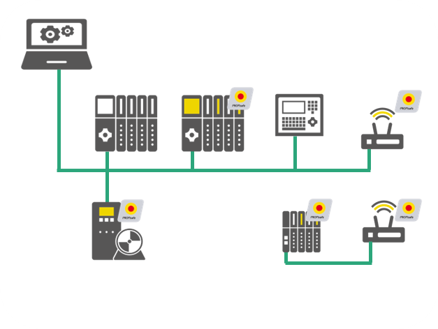

Since PROFIsafe is an optional feature, not all PROFINET devices support PROFIsafe. The user must select the appropriate safety components to implement PROFIsafe. During implementation, the user must select network components that require safety; only those network components require PROFIsafe capabilities.
The overall network configuration may contain a mix of fail-safe and standard components. The diagram below shows an example of a PROFINET network with a mix of PROFINET components; some have PROFIsafe capabilities (yellow); others do not (gray). Also, PROFIsafe is designed to work independently of the base transmission channel, whether that channel is copper wire, fiber optics, wireless, or a backplane.
