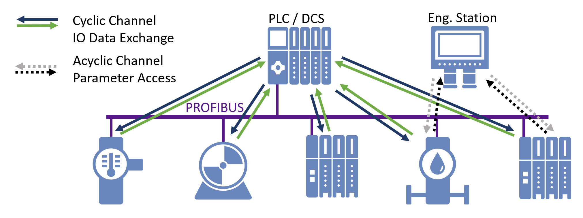

The communication basis for PROFIBUS lies in the cyclic data exchange between PLCs (masters) and devices (slaves). PROFIBUS components communicate using the PROFIBUS DP (Decentralized Periphery) communication protocol, which is the same for all applications and which allows cyclical and acyclical communication.
The core of the communication process of PROFIBUS DP is the master-slave method. A cycle will consist of a master sending outputs to, and receiving inputs from all of its devices, and then repeating the cycle. This process also includes a device-, module-, and channel-specific diagnostics.

PROFIBUS employs a master-slave interaction between its network components. In a master-slave interaction, the master has unidirectional control over all its slave devices and processes. The controller will always be the master, and the IO devices will always be slaves.
The polled slave answers the prompting master with a response message. The request message contains the output data, and the associated response message includes the input data. Finally, a bus cycle comes to an end once all connected slaves have been polled in order.
In addition to cyclical communication for the fast exchange of input and output data between the master and slaves at regular intervals, need-based data can also be transmitted using PROFIBUS, e.g., device setting data. A master has the initiative, accessing the data of a slave in read or write mode acyclically.
A crucial part of the acyclical data exchange process is the writing or reading of device parameters at the behest of the master. These device parameters can be used by a centralized operator tool to configure a field device, thereby adapting it to the specific task it has been charged with performing in the technical process.

PROFIBUS DP Master Class 1
A PROFIBUS DP master of class 1 (DPM1) is a master that uses cyclical communication to exchange process data with its associated slaves. Devices of this type are often integrated into a memory programmable controller or an automation station of the process control system.
PROFIBUS DP Master Class 2
A PROFIBUS DP master of class 1 (DPM2) is a master that can be used to set device parameters via acyclical communication. Devices of this type are usually part of an engineering station used for device configuration.
