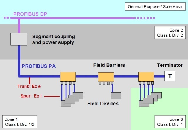

PROFIBUS PA and DP
PROFIBUS PA enables long cable distances and explosion protection in process automation as well as the native, digital integration of field instrumentation in control systems and asset management systems. Based on the current state of the art, the connection is typically by means of a link or coupler via PROFIBUS DP.
The user benefits of PROFIBUS PA result from, among other things, the use of digital communication instead of analog communication, the suitability for easy proof of intrinsic safety type of protection, and the properties of the PA device profile oriented to the process industry.

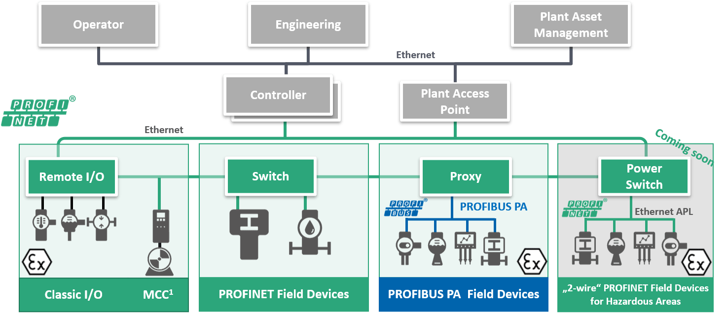

PROFIBUS PA and PROFINET
It is also possible to implement PROFIBUS PA in PROFINET networks. The connection to PROFINET systems is by means of a “proxy”, which is a transition that acts as a master in the PA system but as a bus node (device) in the PROFINET system, which allows the PA segment to be easily configured in PROFINET. As a result, the proxy is integrated into the PROFINET infrastructure in the same way as the directly connected remote I/O stations, Motor Control Center (MCC), or PROFINET field devices.
